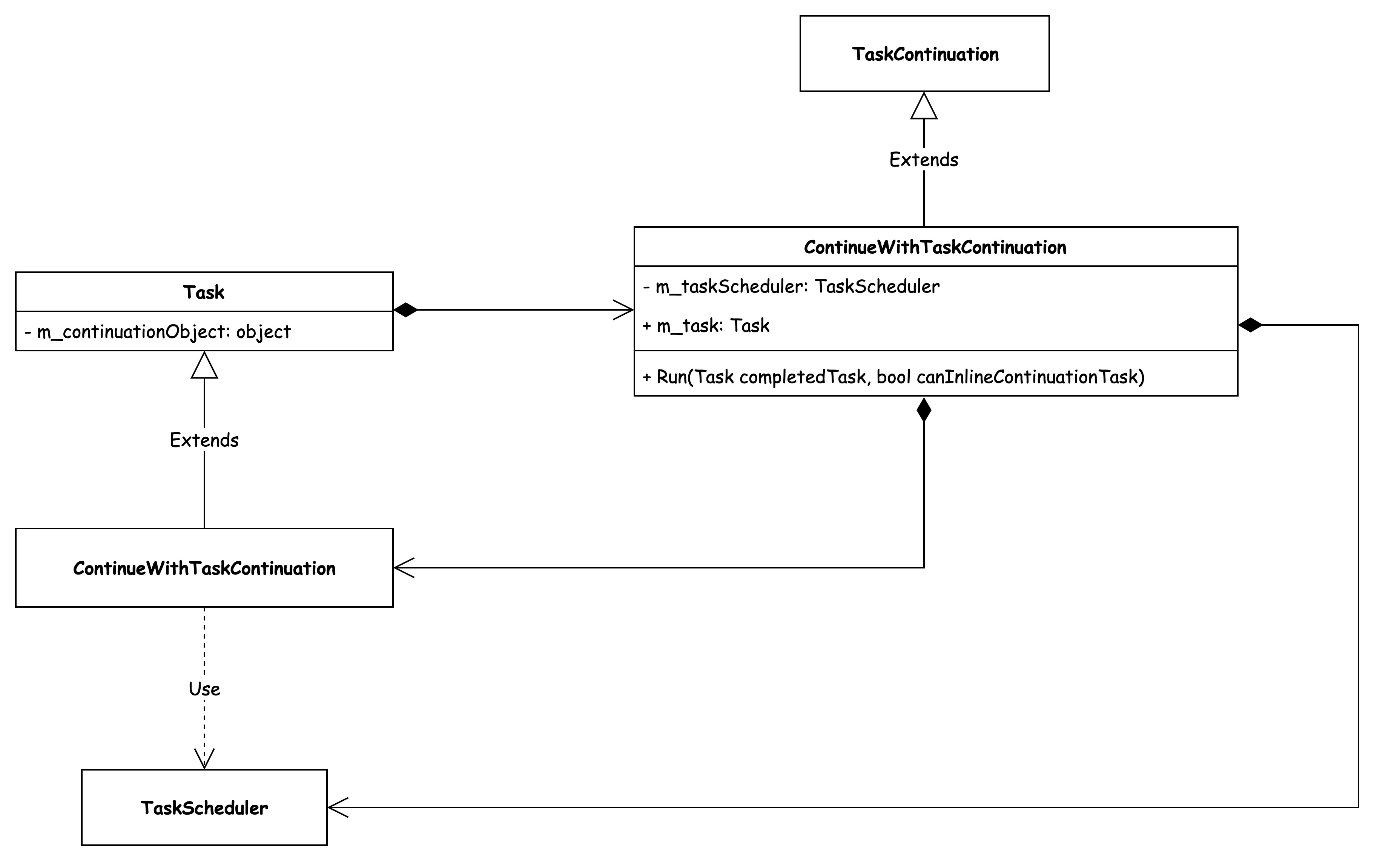

ContinueWithTaskContinuation 的父类 TaskContinuation 是一个抽象类。除了 ContinueWithTaskContinuation,还有别的实现。
internal abstract class TaskContinuation
    internal abstract void Run(Task completedTask, bool canInlineContinuationTask);
ContinueWithTaskContinuation 维护着 Task 执行相关的两个核心对象,一个是 Task 本身,另一是 TaskScheduler。真正执行回调之前,需要先调用 TaskContinuation.Run。
internal sealed class ContinueWithTaskContinuation : TaskContinuation

回调执行真正的决定者:ContinueWithTaskContinuation
在 ContinueWithTaskContinuation 中维护着待执行的 ContinuationTask 以及决定 ContinuationTask 最终执行方式的 TaskContinuationOptions 和 TaskScheduler。
    internal Task? m_task;
    internal readonly TaskContinuationOptions m_options;
    private readonly TaskScheduler m_taskScheduler;
    internal ContinueWithTaskContinuation(Task task, TaskContinuationOptions options, TaskScheduler scheduler)
        m_task = task;
        m_options = options;
        m_taskScheduler = scheduler;
    internal override void Run(Task completedTask, bool canInlineContinuationTask)
        Task? continuationTask = m_task;
        m_task = null;
        // 检查任务的完成状态,如果不符合 TaskContinuationOptions 的设置,回调就不会被执行
        TaskContinuationOptions options = m_options;
        bool isRightKind =
            completedTask.IsCompletedSuccessfully ?
                (options & TaskContinuationOptions.NotOnRanToCompletion) == 0 :
                (completedTask.IsCanceled ?
                    (options & TaskContinuationOptions.NotOnCanceled) == 0 :
                    (options & TaskContinuationOptions.NotOnFaulted) == 0);
        // 任务完成状态符合要求,回调执行。
        if (isRightKind)
            continuationTask.m_taskScheduler = m_taskScheduler;
            // 直接执行回调或将其排队等待执行,具体取决于是否需要同步或异步执行。
            // 默认执行路径,上层传的是 true。
            if (canInlineContinuationTask && // 调用Run方法的内部方法传了允许内联
                (options & TaskContinuationOptions.ExecuteSynchronously) != 0) // 注册回调的实际用户设置了同步执行
                InlineIfPossibleOrElseQueue(continuationTask, needsProtection: true);
            else
                try { continuationTask.ScheduleAndStart(needsProtection: true); }
                catch (TaskSchedulerException)
                    // 如果 Task 执行失败了,ScheduleAndStart 方法会将 Task 标记为失败,
                    // 这里是runtime设计的时候保证不会有意外的错误发生,仅做catch,不做处理
        else
            Task.ContingentProperties? cp = continuationTask.m_contingentProperties;
            if (cp is null || cp.m_cancellationToken == default)
                continuationTask.InternalCancelContinueWithInitialState();
            else
                continuationTask.InternalCancel();

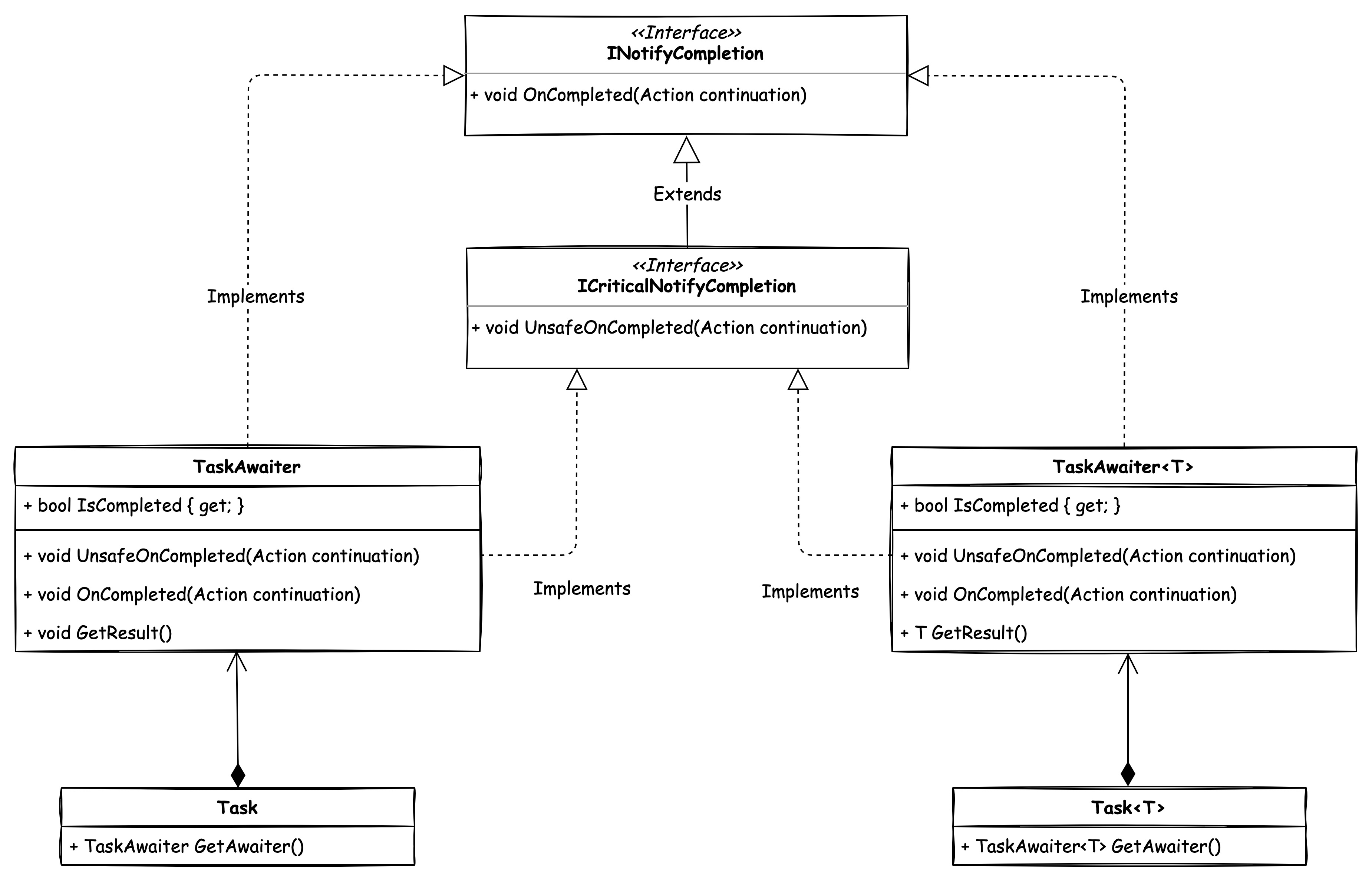

Awaiter
我们可以通过 Task.GetAwaiter 从 Task 实例上获取到 Task 对应的 TaskAwaiter 对象。并且可以通过 TaskAwaiter.OnCompleted 方法注册回调,其执行结果与 Task.ContinueWith 一致。
TaskAwaiter awaiter1 = Task.Run(()=> Console.WriteLine("Hello")).GetAwaiter();
awaiter1.OnCompleted(()=> Console.WriteLine("World"));
TaskAwaiter<string> awaiter2 = Task.Run(()=> "Hello").GetAwaiter();
awaiter2.OnCompleted(()=> Console.WriteLine($"{awaiter2.GetResult()} World"));
Console.ReadKey();
Hello World
Hello
World
注意:直接调用 TaskAwaiter.GetResult 会阻塞调用线程直至 Task 执行完成。
TaskAwaiter 本质上可以理解成在 await 语法糖编译成的代码中,为了解耦 Task 和状态机,而创建的一个隔离层,内部对 Task 进行了包装。
public class Task<TResult>
    public TaskAwaiter<TResult> GetAwaiter() => new TaskAwaiter<TResult>(this);

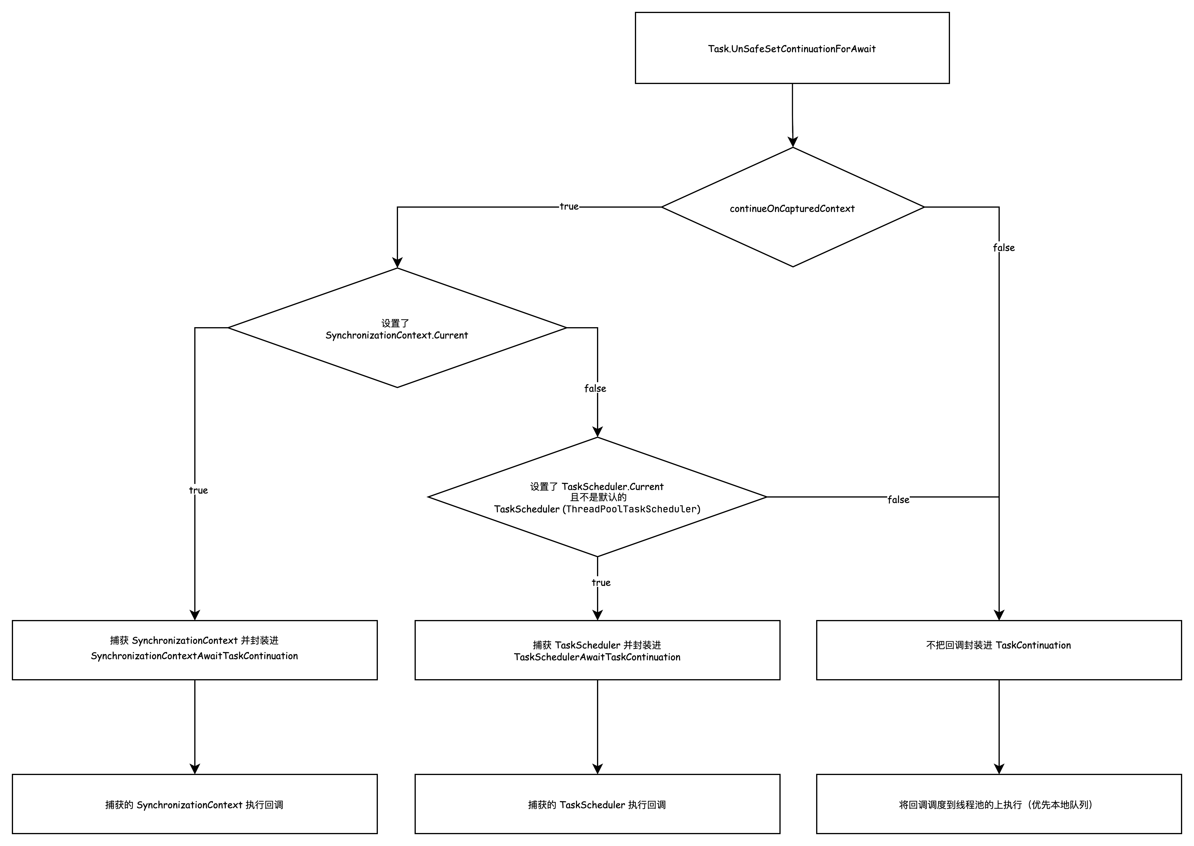

    internal void SetContinuationForAwait(
        Action continuationAction, bool continueOnCapturedContext, bool flowExecutionContext)
        TaskContinuation? tc = null;
        if (continueOnCapturedContext)
            SynchronizationContext? syncCtx = SynchronizationContext.Current;
            if (syncCtx != null && syncCtx.GetType() != typeof(SynchronizationContext))
                tc = new SynchronizationContextAwaitTaskContinuation(syncCtx, continuationAction, flowExecutionContext);
            else
                TaskScheduler? scheduler = TaskScheduler.InternalCurrent;
                if (scheduler != null && scheduler != TaskScheduler.Default)
                    tc = new TaskSchedulerAwaitTaskContinuation(scheduler, continuationAction, flowExecutionContext);
        if (tc == null && flowExecutionContext)
            tc = new AwaitTaskContinuation(continuationAction, flowExecutionContext: true);
        if (tc != null)
            if (!AddTaskContinuation(tc, addBeforeOthers: false))
                tc.Run(this, canInlineContinuationTask: false);
        else
            if (!AddTaskContinuation(continuationAction, addBeforeOthers: false))
                AwaitTaskContinuation.UnsafeScheduleAction(continuationAction, this);
public readonly struct TaskAwaiter<TResult> :
    ICriticalNotifyCompletion,
    INotifyCompletion,
    ITaskAwaiter

  1. ICriticalNotifyCompletion,INotifyCompletion 这两个接口。而 ICriticalNotifyCompletion 是 INotifyCompletion 的子接口。
public interface INotifyCompletion
    void OnCompleted(Action continuation);
public interface ICriticalNotifyCompletion : INotifyCompletion
    void UnsafeOnCompleted(Action continuation);
  1. 提供 IsCompleted 属性 和 void GetResult() / TResult GetResult() 方法。GetResult 方法是否有返回值取决于 await XXXAwaitable 是否想提供返回值。
实际上,我们自己想要实现一个 Awaitable 的话,Awaiter 只需要实现 INotifyCompletion 接口或者 ICriticalNotifyCompletion 就可以了。

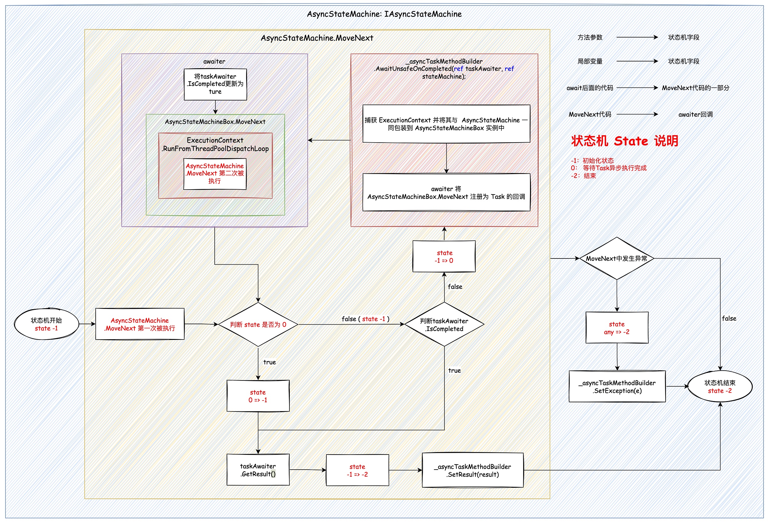

OnCompleted 和 UnsafeOnCompleted 的唯一区别是在调用 TaskAwaiter.OnCompletedInternal 时,flowExecutionContext 这个参数有所不同。
ExecutionContext 的本质是一个线程私有变量,维护着我们常用 AsyncLocal 的数据,例如 Thread.CurrentThread.CurrentCulture 其实就是一个 AsyncLocal 变量。
runtime 中会在发生线程切换的地方,将 ExecutionContext 从前一个线程拷贝到后一个线程。那么第二个线程里也就可以拿到在第一个线程里设置好的 AsyncLocal 变量。
就算线程没有发生切换,runtime 里有的地方也会通过清空 ExecutionContext 来阻止其往后传播。
更多 ExcutionContext 和 AsyncLocal 的解析,请参考我之前的一篇博客:
https://www.cnblogs.com/eventhorizon/p/12240767.html
也就是说 OnCompleted 会保证 ExecutionContext 往后传播。而 UnsafeOnCompleted 则不会。我们来看下面这个示例。

观察下面这么一个常见的 await 使用场景,可以将 FooAsync 方法内部的逻辑分为三种状态(即 三个阶段):
  1. 初始化状态
  2. 等待 BarAsync 执行完成的状态
  3. 执行结束状态

编译器在 Program 中创建了一个内部类,也就是 FooStateMachine 这个状态机,而 FooAsync 方法则变成了对这个状态机的使用。
AsyncTaskMethodBuilder 的作用解释放到下一篇文章再解释,这边简单理解成 AsyncTaskMethodBuilder.SetResult 就是 FooAsync return 返回值,AsyncTaskMethodBuilder.SetException 就是 FooAsync 内部往外扔异常。
完整的流程如下图所示:
一个方法中就算有个 await,这个方法也只会有一个对应的状态机。就.NET 6 SDK 的编译结果来看,state 会出现 -1 => 0(等待第一个Task异步执行完成) => -1 => 0(等待第二个Task异步执行完成)这样的流程。

回忆一下上文 Task.ContinueWith 讲回调最终封装到了 ContinueWithTaskContinuation。
返回值是 Task 的情况下状态机所绑定的 AsyncTaskMethodBuilder 的所会调用 Task.UnsafeSetContinuationForAwait 实例方法。里面会根据不同的条件创建不同的 TaskContinuation。
UnsafeSetContinuationForAwait 中的逻辑和后续回调执行流程大致如下:
值得注意的是,当前上下文设置的 TaskScheduler 并不能通过 TaskScheduler.Current 获取,而应该通过 TaskScheduler.InternalCurrent 获取。

        return new ConfiguredTaskAwaitable(this, continueOnCapturedContext);
为什么没有同步上下文也会死锁
我们的 Web Api 项目中,默认是不存在 SynchronizationContext 的。那为什么有的同学还会遇到死锁问题呢,而且主要是高并发的情况下,本地可能没办法复现。
这个和 ThreadPool 中的 Starvation Avoidance 机制有关。
DoSthAsync().GetAwaiter().GetResult() 会阻塞线程池线。.NET 6之前极端情况导致线程池无可用线程,导致所谓的“死锁”。
  1. TaskContinuation:维护回调和调度回调。
  2. Awaiter:对 Awaitable 进行封装,负责与状态机进行交互。
  3. 状态机:由编译器生成,每个 async 方法 有且仅有一个,await 后面的代码会被编译到 状态机 的 MoveNext 方法中,注册为 Task 的回调。
